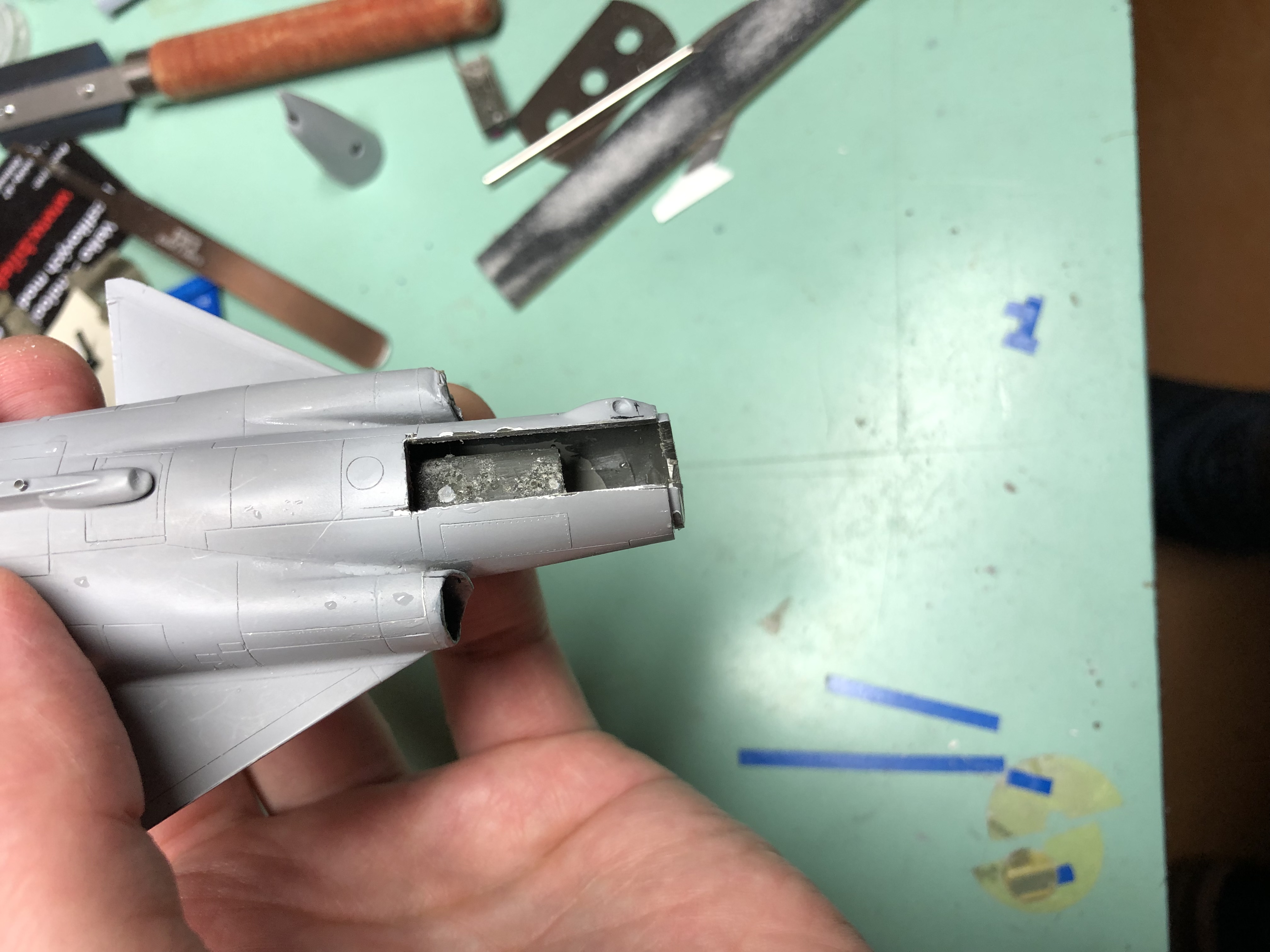

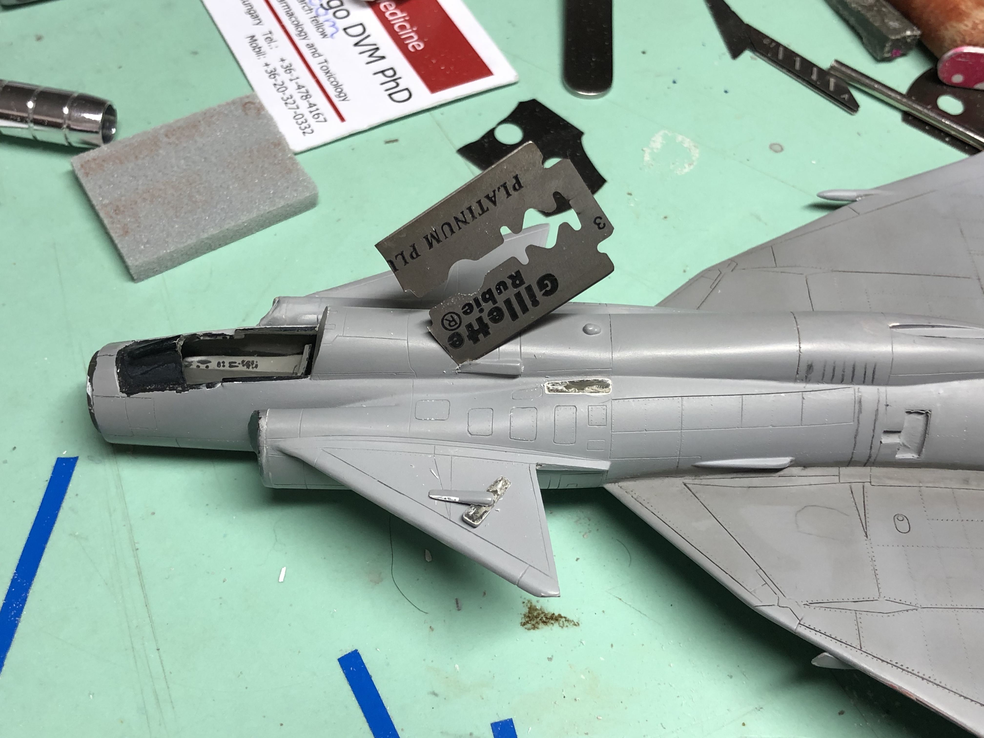

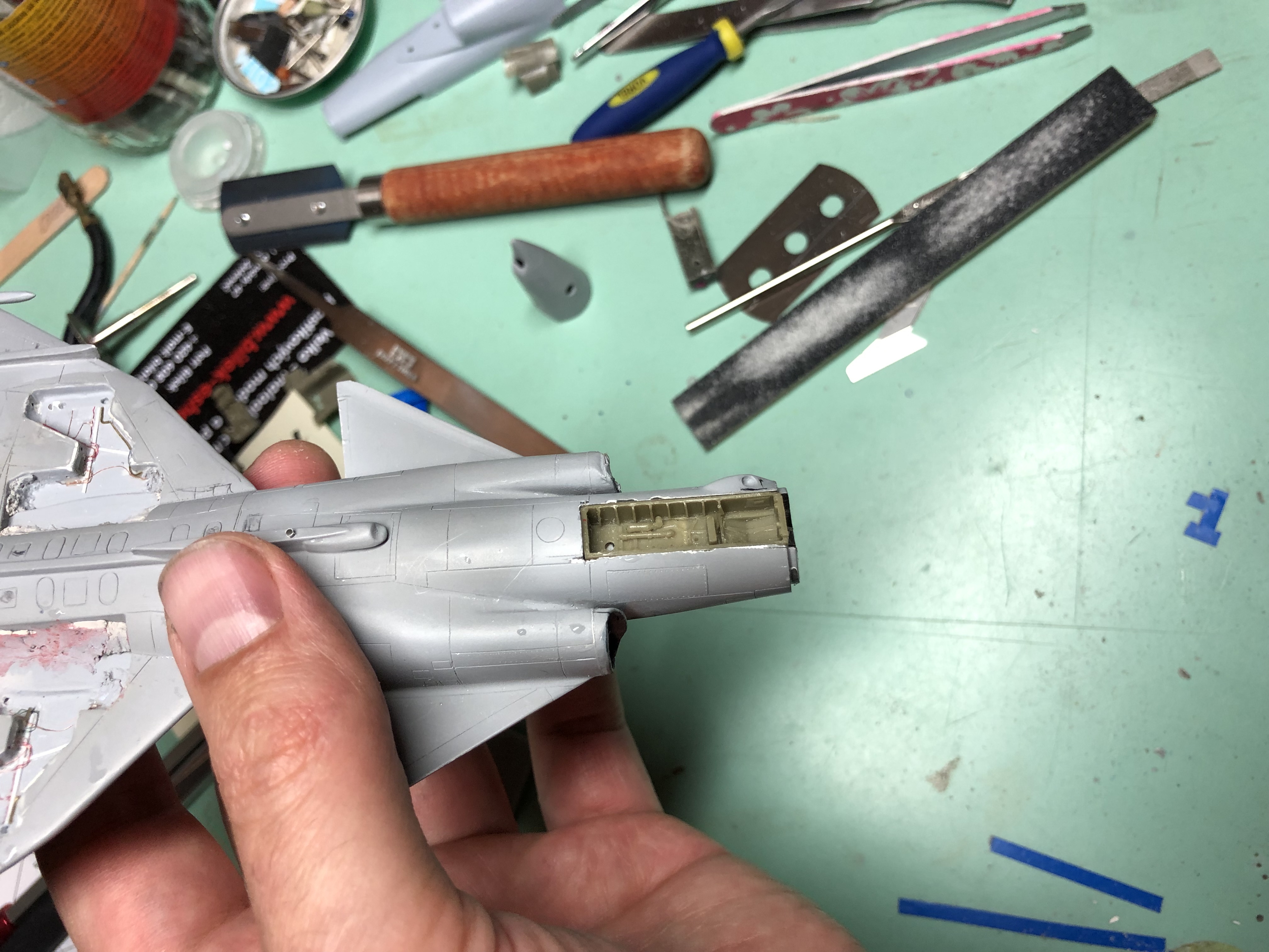

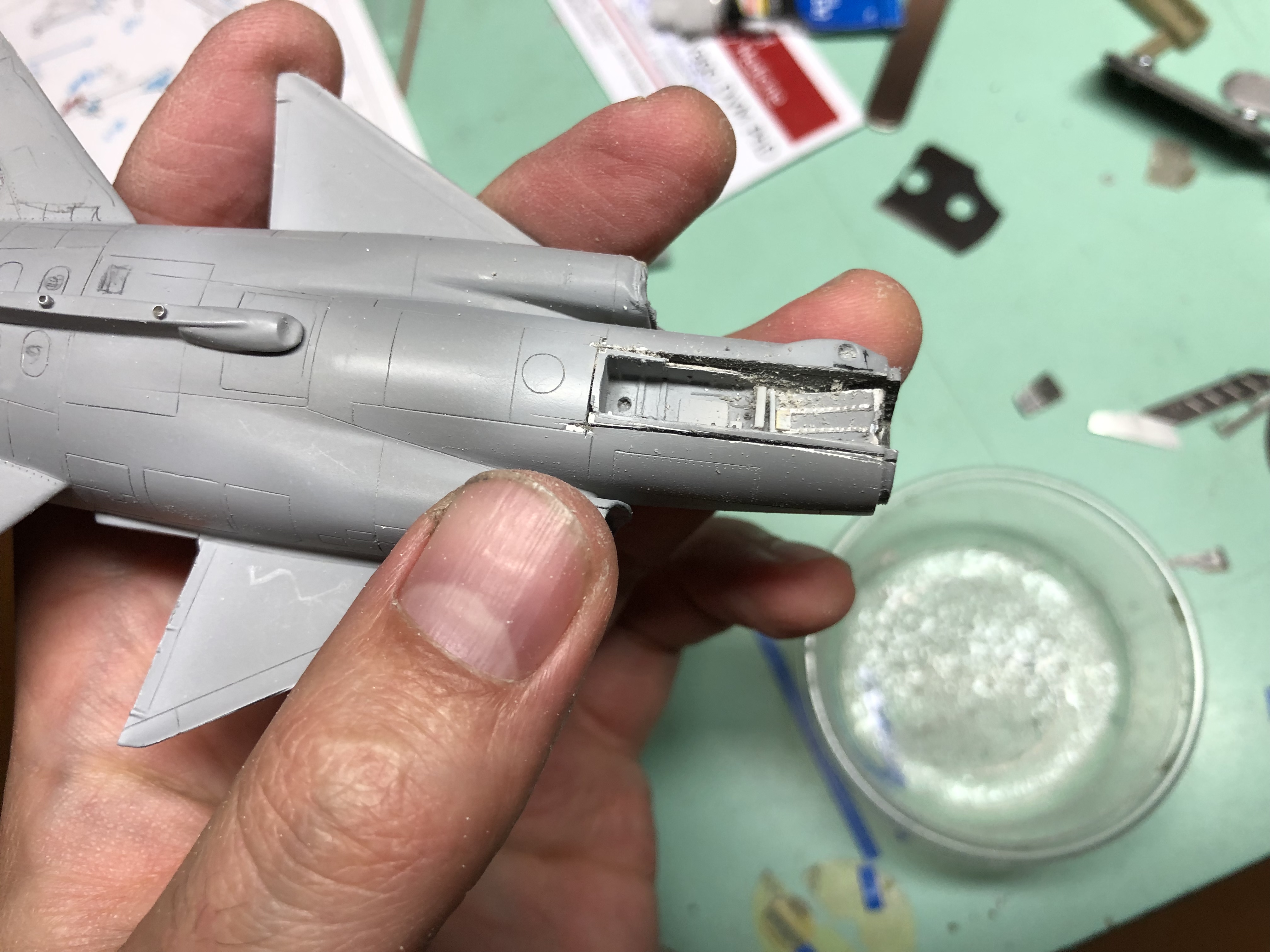

Next thing I did, I took a decision to use aftermarket wheel bay from MM, at least on the front. I tried to detail it myself before, but I was not able to fix main issue - to give more space for retracted front wheel. This would require to cut it on pieces anyway...
I used JLC Saw here
I used JLC Saw here
Ready for new one
Ready for new one
Part from Maestro Models resin kit
I do not put it on glue yet. I also need to replace cockpit ;)

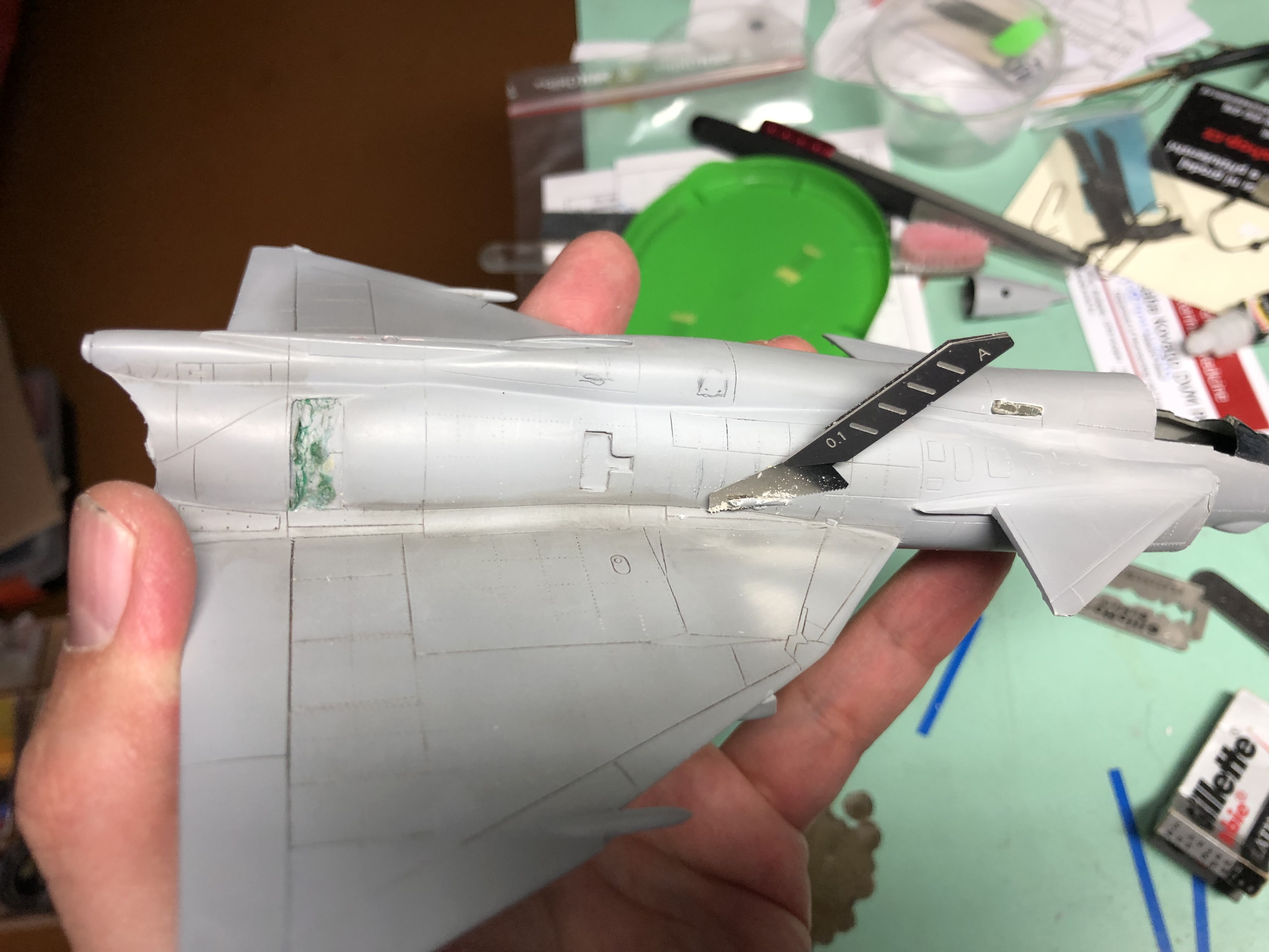

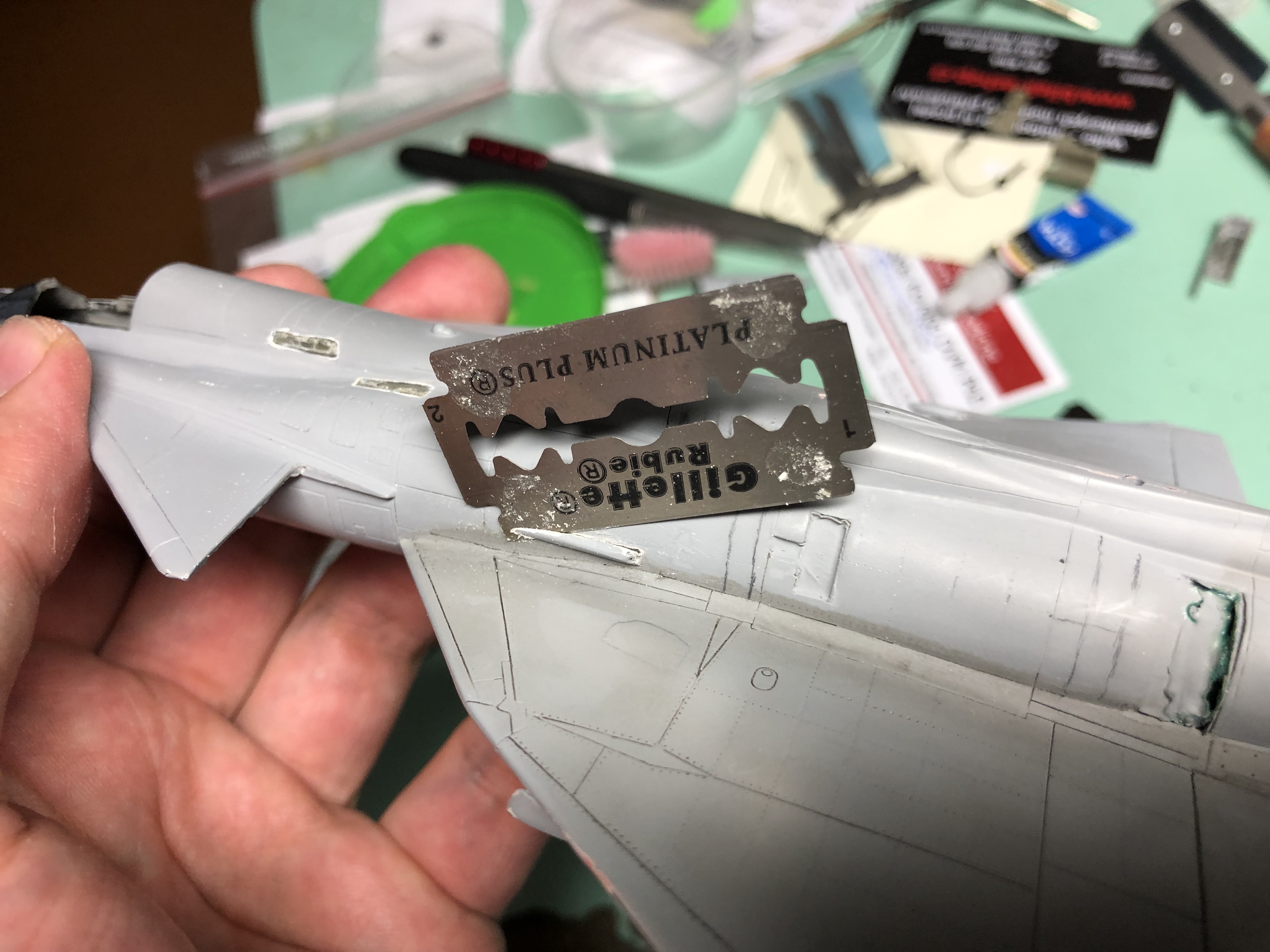

Next step is to cut away ventilation tubes.
The tubes on the sides are "blended" into fuselage, no like on real one.
And I want to make holes in the ventilation tubes behind cockpit. But the only solution I see is to make tubes from thin metal.
Also I will be able to fix one thing. Tubes behind cockpit has different size: on the right is wider an taller then one on the left.
VolshebNik
Inlägg: 115
Blev medlem: 21 aug 2012, 12:50
Namn: Nikolaj
Ort: Riga, Latvia
Re: My “first” Viggen. Heller 1/72 SAAB SF37
Inlägg av VolshebNik »
This is how it looks after cut.
New side left tube done from different size of tubes and CA glue applied. Then sanded to get the shape.
Front part of the tube has a small hole, like on real Viggen.
