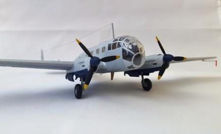

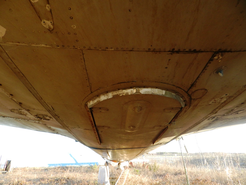

I have learnt a little of the five Nord NC701 used by the Swedish National Mapping Authority while building all five in 1/72 scale. I have not studied SE-KAE nowadays belonging to the Swedish Air Force Museum as it is stored in a closed storehouse. I made a small walk-around of SE-KAL at Arlanda Aviation Collection and I have enclosed a photo of the camera opening on the underside. I assume they only had a kind of sighting equipment in the cock-pit that you are mentioning as a visual device. Be aware of that that all 5 planes had differences and they also looked different during their operational period.
All my five built Nord NC701 Martinet are based on the SMER/Kopro/KP Models Siebel models made with the same tool. Not the highest quality and rather difficult to achieve a "good enough level". I have now found some KPM kits with the correct NC701 Martinet version and will make 5 new models.
